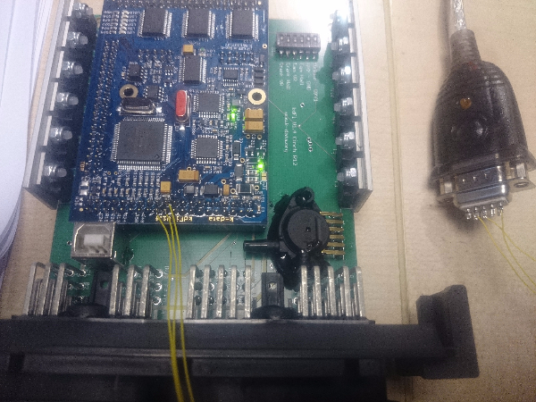

i found out KDFI has the CJ125 RXD and CJ125TXD line coming out, just need to figure out how i need to communicate with the wideband controller chip.. how the pinout is from the RS232 and what programme i need...

You have to connect the CJ125 rs232 interface to the pc.
There is no program available for this, just use hyper terminal or similar.

KDFI 1.4 cinch, i got a basic board as well.
Can i use a RS232 to usb cable ? and what wire needs to what pin ?
like this Pin 2 RXD Pin 3 TXD Pin 5 GND ?

you would also need a TTL<->RS232 adapter because the rxd and txd pins have TTL level.

thanks i got the cable correct i am sure.
https://www.antratek.nl/rs232-to-ttl-converter-module
is this usable, going to order now.

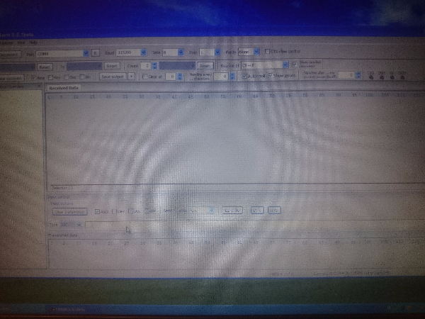

i got the Circuit in today for USB to Serieel TTL,
works great !
But now....
when i press connect it keeps rolling in data...
see this movie :
https://www.youtube.com/watch?v=A2c1CW3snvc
works great !
But now....
see this movie :
