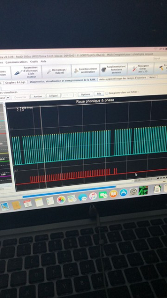

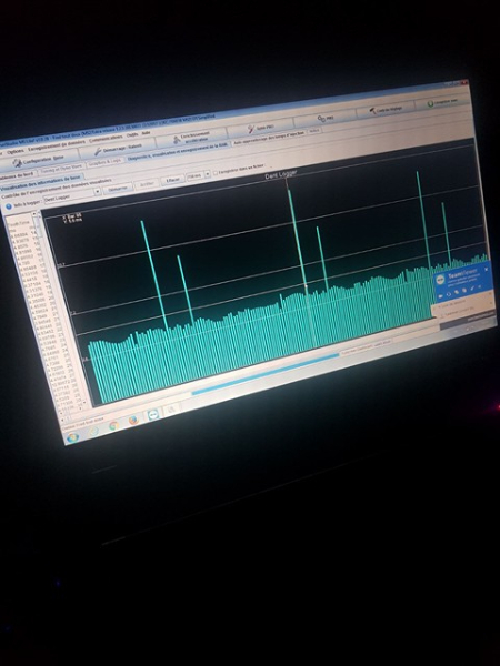

Re: Vr6 turbo with Kdfi v1.4 PnP
Beitrag von fredoux »
With configuration but not good
After
After
Before
Before
